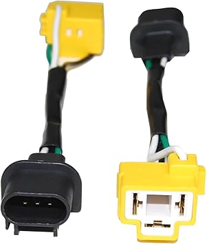

They are still available. I went from the stock 13 year old sealed beams (were still the originals) to the Hella Vision Plus from Amazon along with the Hella Vision Plus H4 conversion headlights. The stock Hella bulbs weren't as good as I liked, so I installed the Osram Night Breaker bulbs which were a brighter white. I made a mistake and bought a set of cheap H13 to H4 pigtails and one pin in the H13 socket kept pushing out rather than connecting. I then bought a good set of KC-HiLite pigtails. Here are the links:
All three pieces list on Amazon for about $148. The H13 to H4 adapters are now more expensive than 5 years ago, but the Hellas and bulbs are a little less.
