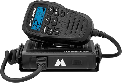

Has anyone compared the Midland MXT275 with this one: Retevis RA86 ? The price certainly fits in my budget but I don't know anything about the company. We already have a Midland 275 in one Jeep and we want another radio in our other Jeep, and in the motorhome.

GMRS? We use the Midland MXT275 exclusively. In all three vehicles. We chose that one because vehicle interiors are cramped, there is little room for stuff. I'm long past the time when I need blinking lights and flashy displays to impress others. My JEEP has Ham-VHF, Ham-UHF, CB, GMRS and APRS. The APRS is a full TX-RX unit, and it is connected to the 8-inch Android tablet for off-line navigation that replaced the mirror. The stereo was also ripped out and replaced with an android head unit.
The microphones: Right is the CB, all in the microphone display and controls. Middle is the HAM, the display is on top of the dash. Left is the GMRS, again all in the microphone display and controls. Full functionality without a bunch of boxes exposed.
The radio main chassis' are mounted below the seats on a custom-made bracket. Power is fed from a #8 red/blk pair from the battery to a 4-plug Anderdon Power-Pole junction box, each separately fused at the box. Of course there is a main fuse on the feeder right at the battery.
MXT275. Rulers are METRIC.
BTW - the 15-watt output is plenty, gives you up to 10-miles from vehicle to vehicle even when driving through rolling hills. The MXT-575 has 50-watts, but is very expensive for what you get. Hope this helps.
