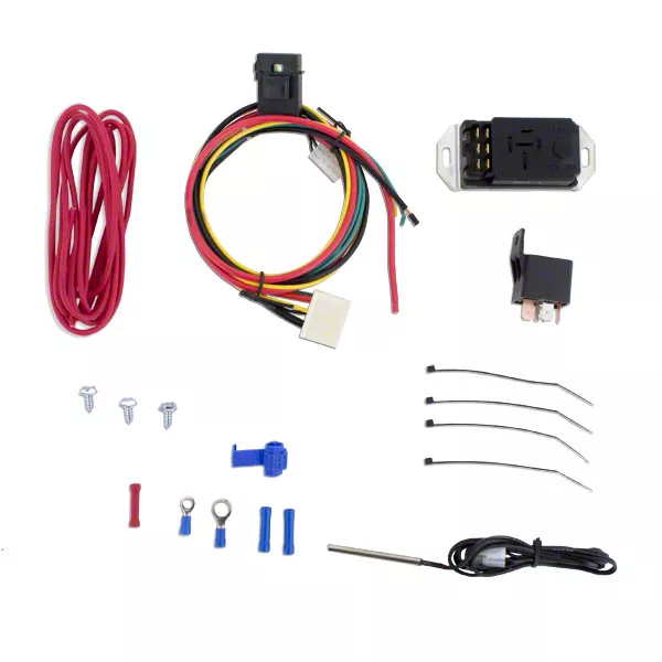

I agree with other members, having more control over then fan would be awesome. If you could have the fan come on sooner than factory it could help stop the coolant temps from creeping up.
