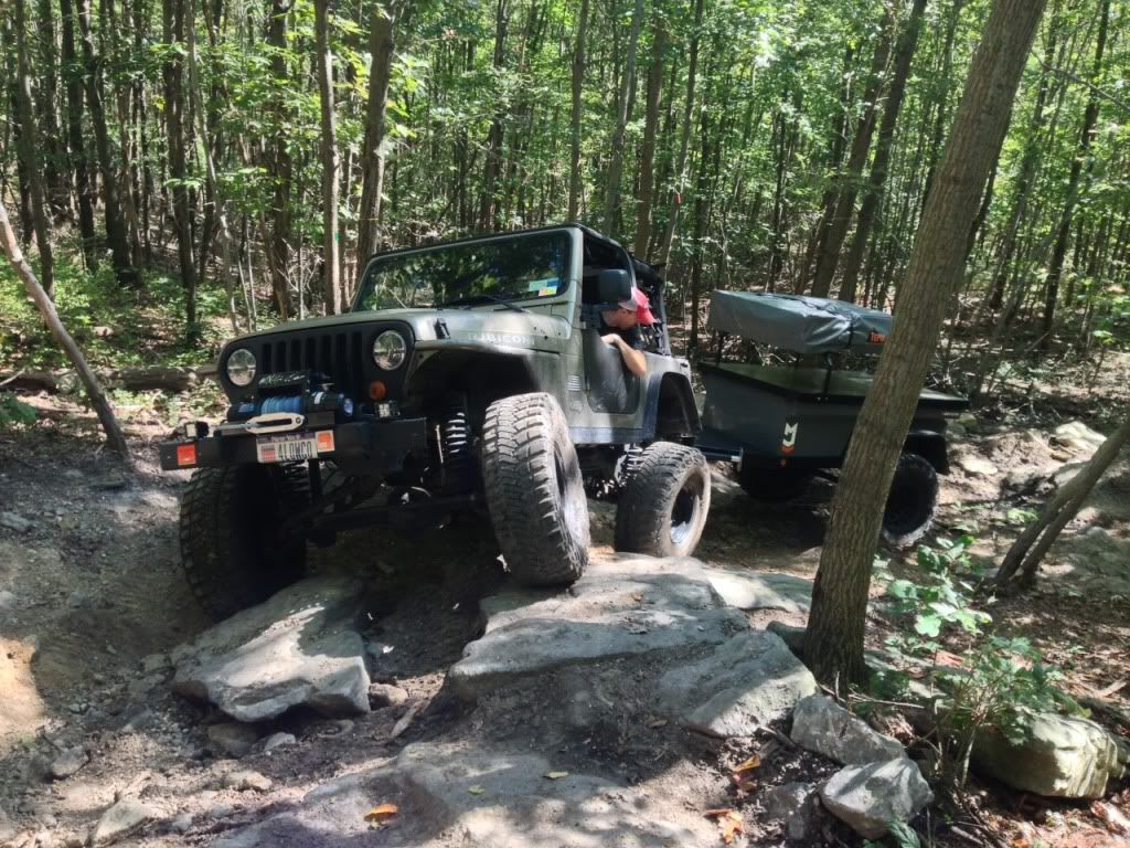

So does that pertain 2 somebody running coilovers which never become unseated? all these pics I'm seeing of ppl flexing their jeep 2 show how well it worx i guess but my rig looks just like them when im flexed out and i dont run a sway bar at all
#25 ·
People are posting flex shots just to show that they can, in fact, still flex with the Anti Rock installed. (something you would not be able to do if your stock sway bar was still connected)
There are advantages of running an anti rock sway bar over running no sway bar when offroad.
