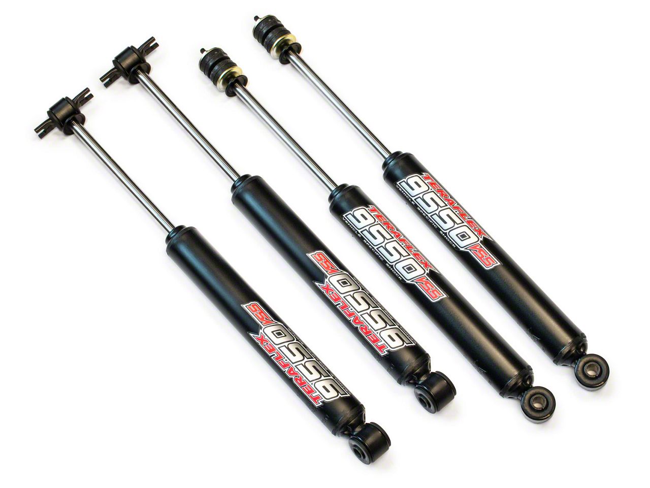

Anyone know anything about these?
I have the 9550's on my daughters JK. The Rancho 5000X are MUCH better.
