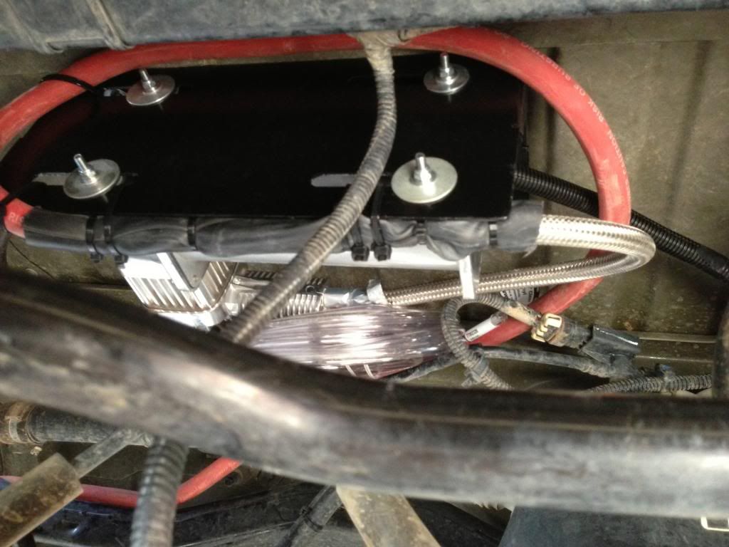

got a ViAir 450C for almost free.. I ended up putting it above the rear axle with a bracket that was made for it..

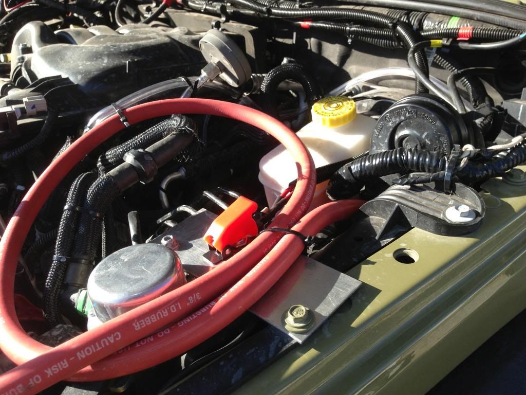

I routed the power, air hose and the fresh air intake along the frame into the engine compartment for now... I installed a switch in the engine compartment also..
you can say I kludged it which I did...
