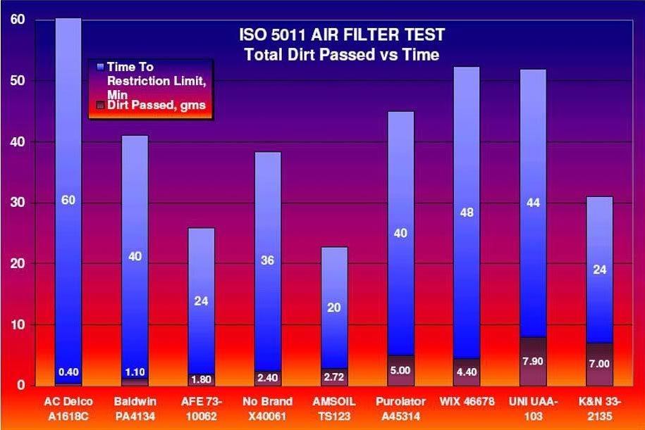

I would like to see K&N or other similar companies run a comparison test. 10k miles in the Northeast, southeast, Mid-South, Midwest, South and North west. Then release the results showing what for dust and particulates get through. Put this to bed once and for all.

not exactly the test based on regions, but dust is dust, if you wheel in it, it will hit your intake. also, its well known that the TJ OEM intake is non restrictive, it allows ~100 cfm more than what the I6 can consume at WOT, so there is no performance gain.

What that graph does not say is how it relates to real world driving conditions and what is the affect on the engine if the measured amount of dirt.
I have used kn on two street vehicles for over 100k on each. There is a drop in kn on the tj from the po and i have over 100k from me (150 on the odometer) my tj sees dust trails only a hand full of times a year and i have no concerns. Does it help performance on the tj, no. Would i use it if i drive in dust all the time, no.
One point a lot of people repeatedly state is the stock filter can pass sufficient air. Well yes. The engine is a positive displacement pump. It is going to pull in the volume of the cylinder. A less restrictive filter is not going to increase the volume of air. Any amount of restriction will make the engine work harder to bring in the air. That uses hp and is less hp it can output to the wheels. Again not saying in the case of the tj that the stock filter robs any measurable amount of hp.

No fan of k&n, but know one has brought up the point that a clean k&n under performs a dirty one. A dirty oiled filter has more surface area to collect more dirt. The purpose of the oil is that the dirt that gets on the filter absorbs the oil, and gets sticky and collects more dirt. So most of there competitor's tests are not very accurate. Was talking to one of k&n's R&D guys years ago at a race and he was telling me how he has to lecture people on why the shouldn't over clean there filters, and how clean hurts there performance.
