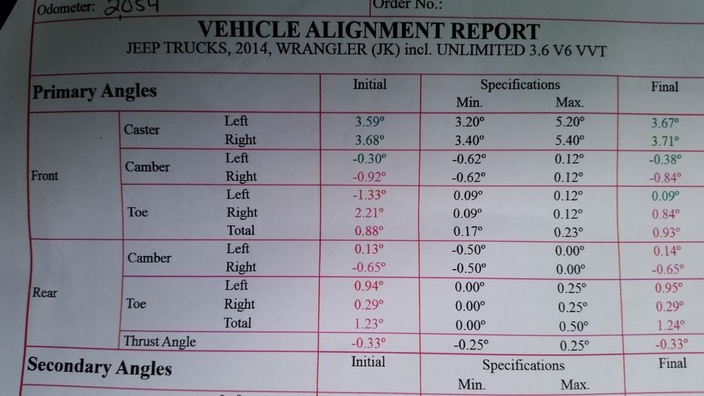

OK first and foremost, this is the mega super damage that the shop thinks bent the axle. I'm still not convinced. The lift went in yesterday, without much issue. Is it possible that the spidertrax spacers are exacerbating the negative camber reading?
This is the print out. He said the front was so far out that he didn't touch the rears, but its definitely enough to chew my tires on the front.

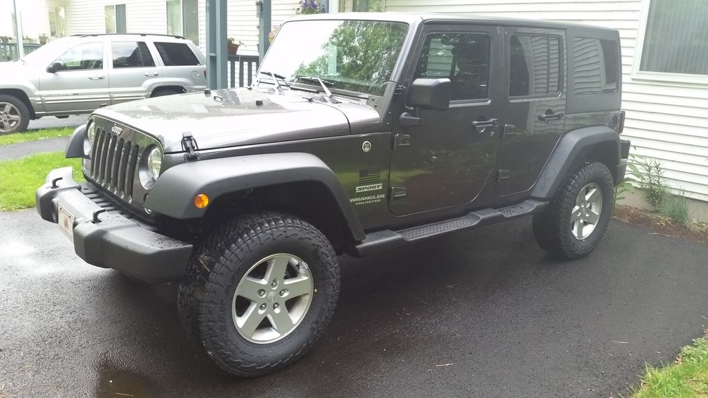

And just because it looks gorgeous, here's the finished product. Tf 2.5 spring lift, spidertrax spacers, and wild peak 285/70R17

No issue with camber under 1*. Many Jeeps come from the factory out of spec on camber.
Your caster at 3.6 is pretty low. It might drive fine, but I'm a stickler for getting to at least 4.5 on a 2.5 lift. I would add some front lower control arms or a set of geometry correction brackets to bring it up.

I don't doubt for a second that the dealer would touch anything under the Jeep at this point with a 10 foot cattle prod. I'm going to follow Kjeeper here and leave it alone... the camber anyway. It drives fine, I might add some corrected LCAs in the future for my own piece of mind, get that caster in a better place. Plus, it's a DD, anything I can beef up to hopefully prevent issues trail riding down the road is a plus.
The shop was concerned that something was bent, which is why they didn't adjust anything. I'm going to call today, I seriously doubt he will have a problem putting it back on the laser rack and squaring everything else up if I told him to ignore the front camber.

So a little update. I had the Jeep back in the shop today to tidy up the toe and straighten the steering wheel (and flip the 3 out of 5 tires that were mounted backwards around). They had it for a full day, 8am to 4pm, and only changed the tires. They said that the camber is so far off (still under 1*) that they couldn't do the toe, then added it was too loose to align. After 2500 miles? Bs. I checked it out, everything seems tight and wiggle free up front. Then the tech comes out and tells me that not only did I bend the front axle tube while I was "smashing it off road", which I didnt, but that the rear alignment must be the result of a bent frame in the back. I think I'm done with this shop.
Im meeting a buddy on weds, we are going to adjust the drag link to straighten the wheel, and I'll just keep an eye on my tires for excessive or uneven wear.
I've also noticed that my rear axle sits about 1" to the drivers side at rest... should I add an adjustable track bar to square it up at rest?
I've noticed a little bumpsteer and she's a tiny bit flighty. I'm going to add new front LCAs or drop brackets on payday, hopefully that will help out some.

That shop has no clue... I can't for the life of me figure out how these places stay open other than they pray on those without any knowledge.
I have a local shop that I go in and they adjust toe and give me a print out for $50. Since nothing else is normally adjusted on a JK.
If it's flighty at all, it's the low caster. The geo brackets work great, but if you are a stickler for ground clearance and don't mind the extra $$ then arms are nice.
