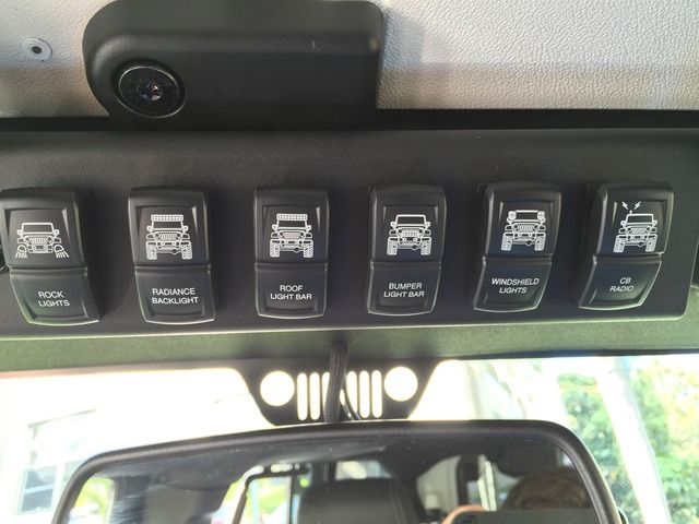

sPod 6 switch with duel LED's

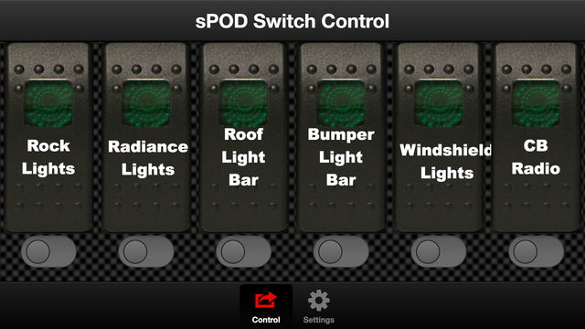

sPod app with the Remote Control Power Module (RCPM) on my iPhone 6+

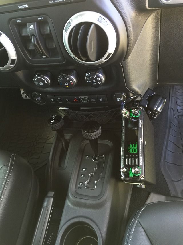

Move your CB to the passenger side with a Quadratec quick disconnect mount.

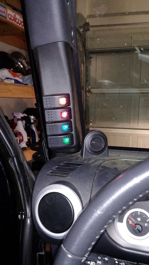

A pillar mount with OTRATTW switches.
Started with Blue/Red LED and decided to switch to Green/Red
So if you want 4 Blue/Red OTRATTW switch bodies let me know ($35 shipped)
You will still have to order the switch covers from OTRATTW.
View attachment 3119705 Red
I really wanted blue LED's before (correctly) settling on red when I heard rumors of how freakin bright the blue was. I can tell from your pics- Wow.

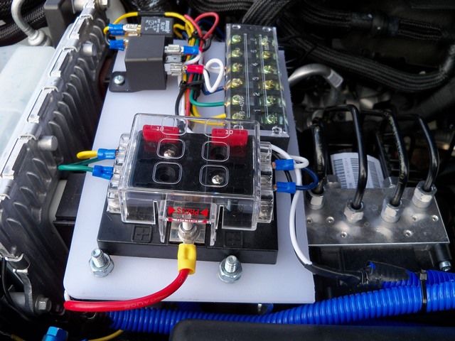

I have the daystar and a Waterproof Fuse Relay box.

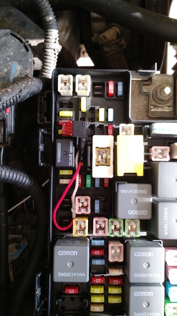

Went with Daystar A-pillar. Ran relays for the switches and the switch lights are powered from the rear seat heater fuse in the oem fuse box (I don't have heated seats). All the switches have a quick disconnect spade terminal behind left side dash cover which are color coded to the switch light color. That way I never have to remove the switch panel to hook up new accessories. And I can disconnect them to lower the windshield.

Routing for the fuse box. Don't need to compromise the water proof seal. can go from underneath.
