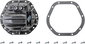

Very informative. I actually think the Dana aftermarket cover might be the same internal shape as the stock cover.
Discussion starter · #24 ·
I ended up measuring the fill holes. From what I can tell, the stock cover is about 1 quarter of an inch above the lower fill hole on the Dana after market cover. So, I think using the lower fill hole on the Dana cover after all is incorrect and I ended up going with @Bob Sanders suggestion. I ended up filling the lower hole on both diffs until it oozed out, plugged it, and then used the upper fill hole to estimate the remaining fluid. I am on the lookout for stock covers now...really don't feel like messing with this or worrying about it every time I need to change fluid. My '17 (Which has stock covers) takes like 5 mins to do, this one is way more of a pain. It's also bulkier and the ribs on it make it a pain to fill.
Also, these covers are WAY heavier than stock. I'd rather save on weight.
