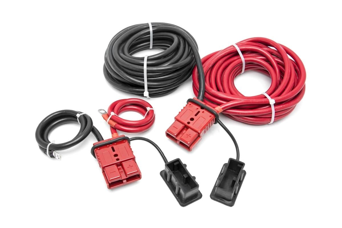

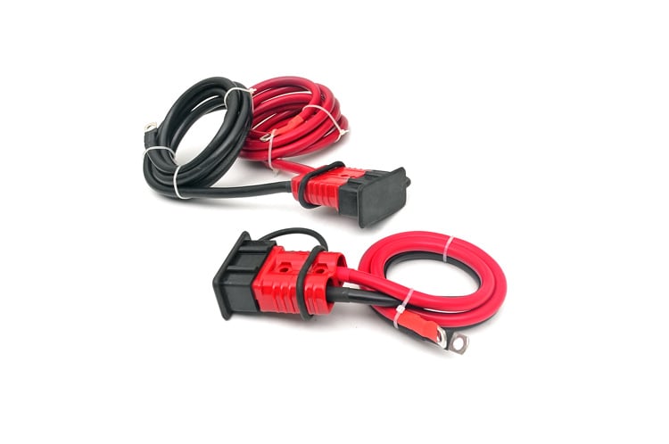

I still have a 9500 Badlands in my garage that I'm contemplating putting on a cradle and using on the back of my F150. Rough Country sells a short and long set of battery cables.
7ft
24ft
#12 ·
If you are mounting the winch on the front of your Jeep it will have plenty of length of wiring. I had a Badland 9500 steel cable winch on my Jeep breifly before switching to a Badland Apex 12k synthetic.

I've considered that, i just saw that the cable from Rough Country is ordered won't hold up on amp but now ordered 2 10' 2/0 that i know will work. Such a pain in the butt lol
