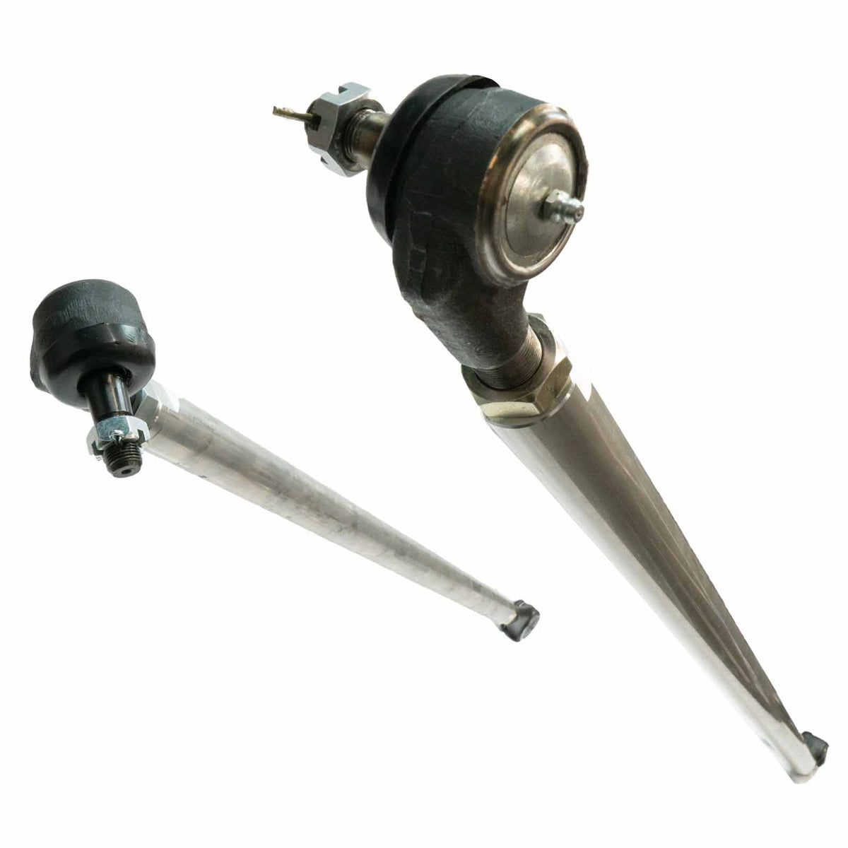

Not a fan of the aluminum steering but you have options in that camp as well and cheaper too depending on components
for example

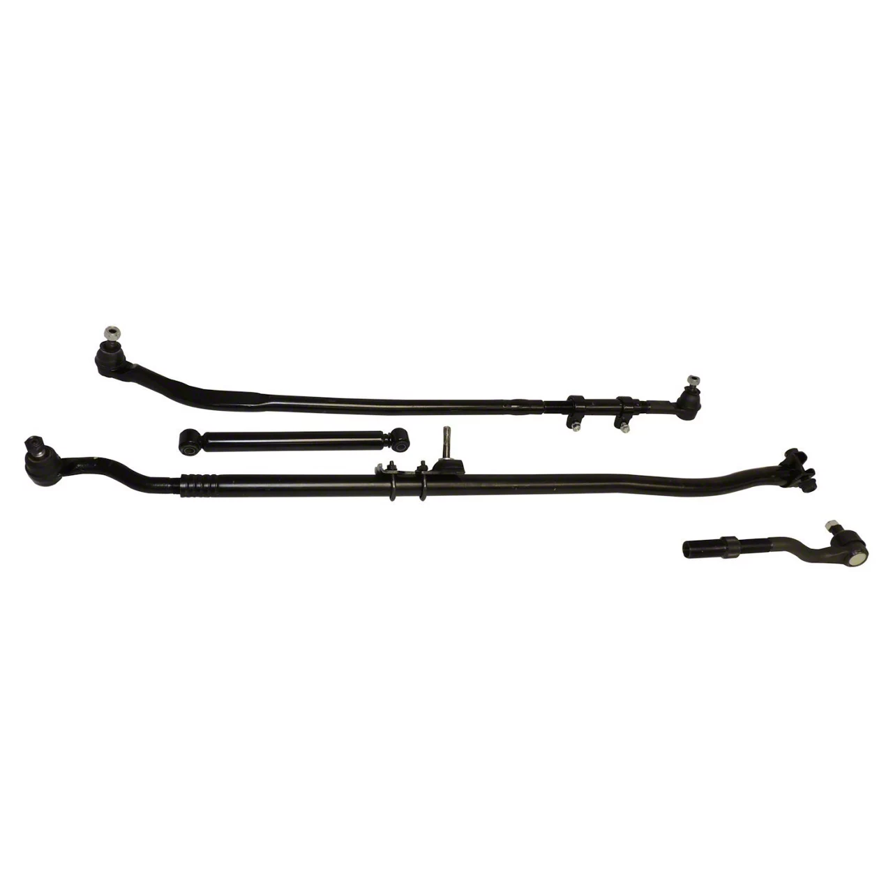

Or if on a budget OE stuff from Crown and the like is cheaper, again this is not HD at all, is OE stuff. Nothing in the OE aftermarket last as long as Mopar does, it's cheaper yes but that's all. I've tried this stuff. This is crap for a year at best, but if you need something now and cheap and you're not doing rocks this will do just fine. It came handy for me once, i'm cheap what can i say :)
