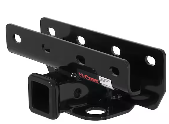

Thinking of one of these for my CB (460lbs). What trailer hitches are out there that you'd suggest other than the standard ClassIII hitch?
As you are probably aware the tongue weight max for most Jeep hitches is 350 lbs. Draw-Tite has the highest rated hitch 675 lbs. But putting a 460lb bike plus the weight of the mount is probably going to overload the rear of the vehicle. Best bet, get a trailer.

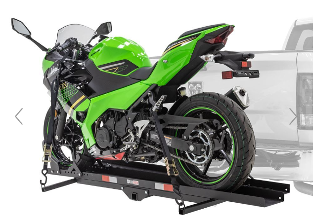

I agree about the trailer. how far is that extended out to get past say a tire and still mount? when they did the ratting for this. Did they figure in the leverage effect of say 600 pounds on a point say 2 feet away? under movement so we have added shock loading. On a Jeep receiver. i would about bet that point twist. in time would cause FUBAR.
Heck i trailer the jeep............maybe i could just mount the jeep to back of the truck? ;)
#12 ·
I did this once on my 2 door with a harbor freight aluminum motorcycle carrier and a ~250 pound dirt bike. I had to remove the spare and the mount for it to clear the bike. I didn't like amount of sag and how all the weight was applied the hitch so I added some ratchet straps back to the shackle mounts on the bumper. After that it was pretty solid and didn't move around much while driving. That said, the front end was a bit light feeling but drove "ok". I also didn't care much for the short ramp on the carrier combined with the high platform height that made loading feel kind of sketchy.
#13 ·
I'm looking at smaller trailers now. Even with a Class III hitch for the Jeep, I just wouldn't trust that motorcycle carrier.
